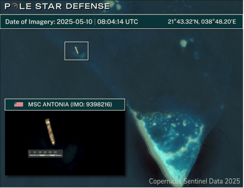

Further analysis indicates that GPS jamming caused the containership MSC ANTONIA to run aground near the Eliza Shoals close to Jeddah Port on May 10, 2025.
Following a review of the available data, Captain Steve Bomgardner, Vice President of Shipping and Offshore at Pole Star Global, has concluded that the vessel’s AIS was subject to GPS jamming, where threat actors introduced fake signals that gave the crew inaccurate positioning information.
The analysis confirms previous reporting from maritime AI specialist Windward that GPS interference was likely behind the incident.
“In reviewing the data, we also concluded that the vessel’s AIS was subject to GPS jamming,” said Bomgardner. “This happens when a threat actor introduces fake signals which the GPS unit picks up as genuine, therefore giving the vessel’s crew an inaccurate picture of where they are.”
Persistent AIS positions fixed MSC ANTONIA within the designated inset boundary, while anomalous southern AIS transmissions are attributed to likely GNSS interference, rather than vessel movement. Image credit: Pole Star Global
