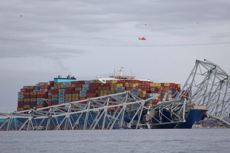

Full view of ship Dali entangled in Baltimore bridge
A view of the Dali cargo vessel which crashed into the Francis Scott Key Bridge causing it to collapse in Baltimore, Maryland, U.S., March 26, 2024. REUTERS/Julia Nikhinson
