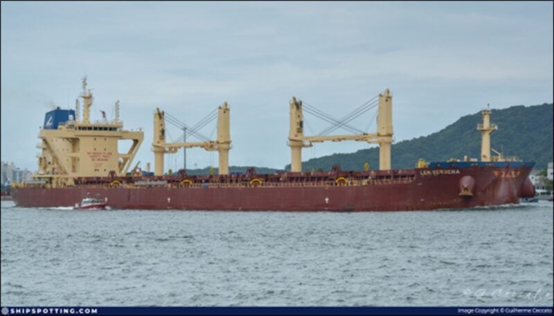

Lem Verbena at sea
MV Lem Verbena. Via NTSB
