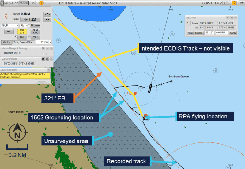

ECDIS screenshot from the ATSB report shows Nuyina’s recorded track (black) diverging from the intended route (yellow), with the vessel following a pre-set bearing line toward an unsurveyed area before grounding near Heard Island.
The grounding occurred as the vessel repositioned about five nautical miles to the northwest following survey operations. The master had planned the route using the aft ECDIS station, but the route did not display on the forward ECDIS used for navigation. As the master worked to resolve the issue, the second officer continued the transit using a pre-existing electronic bearing line that had been used earlier during drone operations along the coastline.
That track led the vessel through a narrow corridor between a charted bank and an adjacent area of uncharted seabed—an area where hydrographic data was incomplete.
Warnings of decreasing depth came from the acoustics operator monitoring the multi-beam system, including a reported depth of about 15 meters followed shortly by a second alert indicating rapidly shoaling water. The master ordered engines stopped and then slow astern, but the vessel grounded moments later.
