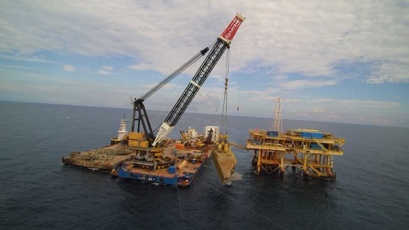

The Conquest MB-1 crane hoists a 600-ton piece of the Troll Solution jack-up wreckage from the Gulf of Mexico. Ardent completed removing the Troll Solution jack-up, the largest salvage job of the year, in November, 2016. Photo: Ardent

To do so, Ardent deployed assets from several countries, including the 1,400-ton lifting capacity Conquest MB-1 crane barge, used by Titan Salvage in the Costa Concordia wreck removal in Italy, as well as a 1,000-ton hydraulic wreck grab from the Netherlands. For the cutting operation, Ardent used a newly designed Guided Guillotine to dismember the jack-up into pieces, instead of cutting with more conventional methods, which it would then lift by crane.
“Traditional methods require either a push or pull-cut with chains or diamond wire. Pull-cuts require tunnels to be bored into the seabed, whereas push-cuts require a large framework to be built around,” said Ardent Naval Architect Roland De Marco.
Ardent says the conventional guillotine cutters are restricted to operations above the surface, but the Guided Guillotine can function underwater with the precision. The salvage team used the device to cut the jack-up’s hull into 31 pieces, while using a chain puller to cut the deck house into six pieces. All were subsequently lifted to the surface using the Conquest MB-1 crane barge.
The the crane barge Conquest MB-1 along with other equipment at the Troll Solution salvage site. Photo: Ardent
“The main hurdles to overcome were, how to best cut the jack-up into sections without fabricating an elaborate structure, and boring holes underneath the jack-up through the seabed was improbable due to obstructions,” said Shelby Harris, Ardent Americas Operations Director.
“We had to apply ingenuity to use our chain cutting techniques on the deck house in a less than conventional method, and the Ardent Guided Guillotine sectioned the hull. The method worked very well,” said Harris.
