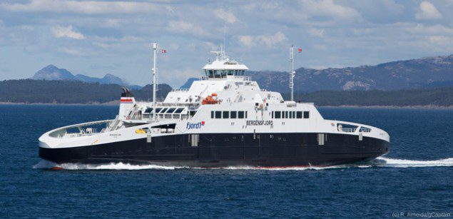

The MV Bergensfjord, pictured at the top of the page, is one of five sister vessels built for Fjord1 and features Promas integrated rudder and propeller systems and four Rolls-Royce BV35:40V12PG gas engines and designed to operate at a speed of 21 knots at 11,800 kW. Two of the five vessels have smaller, 5,000kW propulsion plants and are designed to operate at 17 knots.
Each ferry also carries a pair of 125 m3 lng fuel tanks.
