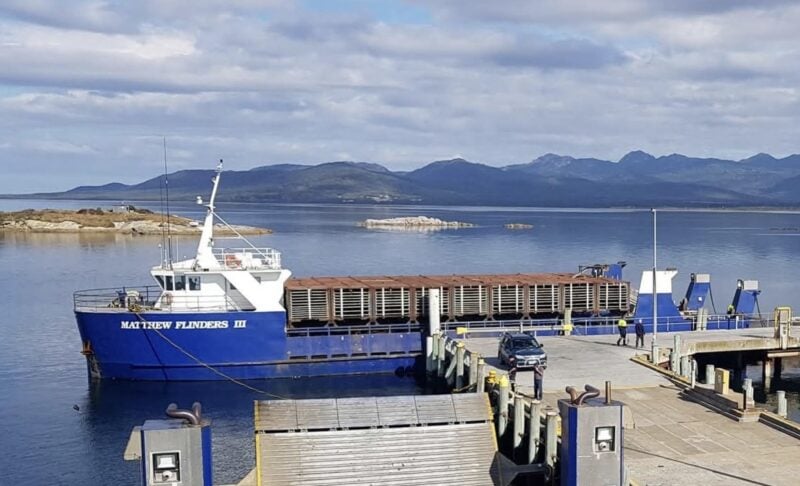

Matthew Flinders III berthed alongside a wharf in Tasmania. The Australian Transport Safety Bureau found the cargo vessel lost steering in Bass Strait in July 2025 after a loose linkage caused an autopilot failure and the crew was unable to use an available backup steering system. (Source: ATSB/Bass Strait Freight)
