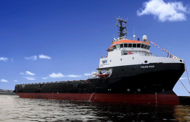

Talha Mar, a PSV 4500
Damen Shipyards announced today the delivery of two, PSV 4500 platform supply vessels, plus another four which are currently under construction and destined for the Brazilian offshore market . These ships are being built under license by Wilson, Sons (Santos, Brazil), for Wilson Sons Ultratug Offshore (WSUT). Deliveries for the four ships under construction will be completed in 2013.

The 4500 DWT vessel has a LOA of 87 m, 16 m beam and maximum draught of 6.19 m, providing a large deck area amounting to 840 m². A diesel electric propulsion system comprising four Caterpillar 3512C generator sets, each of 1,570 ekW at 1,800 rpm, power two Rolls-Royce azimuth thrusters of 2,500 kW. Fixed pitch propellers of 2,800 mm diameter, with nozzle, deliver a speed of 13 knots (at 5 m draught). A Caterpillar C9 genset of 238 ekW at 1,800 rpm is for emergency use. Twin bow thrusters ensure good manoeuvrability and the vessel has a dynamic positioning DP2 classification. There is accommodation for 14 crew and up to six passengers.
