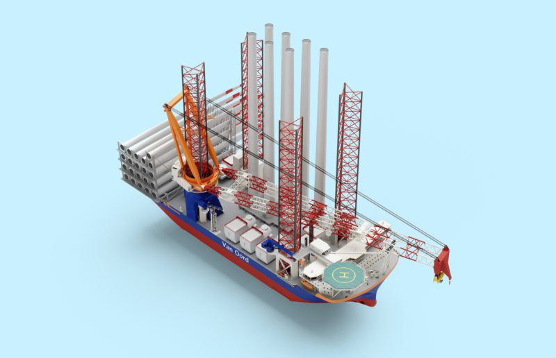

Rotterdam-based Van Oord has placed an order for a new ‘mega’ wind turbine installation vessel (WTIV) capable fo installing up to 20 MW offshore wind turbines.
The jack-up vessel will also be designed to operate on future methanol fuel to reduce its CO2 footprint. Delivery is planned in 2024 from Yantai CIMC Raffles Shipyard in China. The vessel design is by Knud E Hansen and will feature components such as a Huisman crane. The agreement also includes an option on a second vessel.

The new 175-meter WTIV will sail under the Dutch flag and be purpose-built for the transport and installation of foundations and turbines at offshore wind farms. With a top-class crane provided by Huisman, it will lift more than 3,000 metric tons. The vessel will also be designed with an advanced jacking system, with four legs each measuring 126 meters that allow the vessel to be jacked up and work in waters up to 70 meters deep.

“Thanks to our experiences with the installation vessels Aeolus, MPI Resolution and MPI Adventure, we have a good grasp of working with jack-up installation vessels. Now we are going one step further – the new ship will be the largest of its kind. Compared to the Aeolus, this new version has 88% more deck space and over 80% more lifting capacity,” said Arnoud Kuis, Managing Director Offshore Wind of Van Oord.
