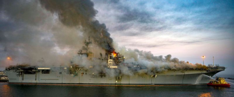

by Megan Rose (ProPublica) On the morning of July 12, 2020, the first orange flickers of destruction took hold in the bowels of the hulking USS Bonhomme Richard as it sat moored at a San Diego naval base.
Unimpeded, the fire gathered force, surging upward, conquering one level of the 844-foot ship and then the next, while the crew — the ship’s critical firefighting force — fled to the pier. There, the captain and his sailors stood by as the Bonhomme Richard burned, in cruel irony of its motto “I have not yet begun to fight.”
Not until the San Diego fire department went aboard did anyone spray water on the fire — nearly two hours after it had started. By then it was too late. Gas cylinders were exploding and shooting through the air, and firefighters didn’t have a map or even a sailor to guide them through the smoky maze of the ship. A firefighter’s warning that a compartment was “about to blast” forced firefighters off the Bonhomme Richard just minutes before an explosion so powerful it was heard 13 miles away and hurled debris onto a nearby destroyer.
That afternoon, the flames, hot enough to warp steel beams, danced along the flight deck and engulfed the ship’s outer structure. As the inferno raged, it melted the inside of the 300-ton control center on top of the ship, spewing molten aluminum onto the decks below.
Before nightfall, the Bonhomme Richard was a salvage heap. Sailors later watched as the forward mast, where the American flag flies while the ship is at sea, collapsed.
Four days later, when the fire was officially out, the U.S. Navy faced the sickening loss of a $1.2 billion warship, not to war, or even at sea. But to a wholly preventable fire while moored in a stateside port. For the Navy, whose reputation as the world’s finest had been battered by recent collisions at sea and allegations of shoddy equipment and training, the loss of the Bonhomme Richard was an embarrassing — and painfully public — blow.
