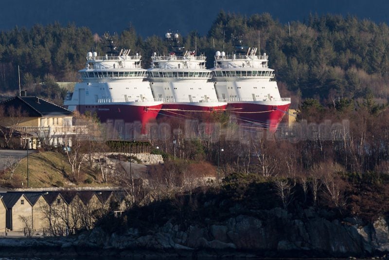

Credit: DigiArt Kay-Åge Fugledal – www.digiart.no
It is always a big financial decision to lay-up a vessel, and with market conditions these days it has become a more frequent occurrence, but how does it actually work and what does one need to take care of?
To lay-up a vessel means to stop using it for a certain period. It will simply be anchored in appropriate waters. The reasons for lay-up might be to wait for a better scrap price or to deactivate the vessel due to over-capacities with the intention of activating it again later. Lay-up periods can be as short as a few weeks and as long as five years and more.
The Norwegian Shipowners’ Association says that in February, 101 of its members’ offshore vessels were in lay-up, as reported on 31st March 2016 – a statistic which is expected to rise. The same is true of container ships. By December 2015 the numbers rose to a new high with 331 reported as idle vessels or 1,36 million TEU (source: Alphaliner.com).
