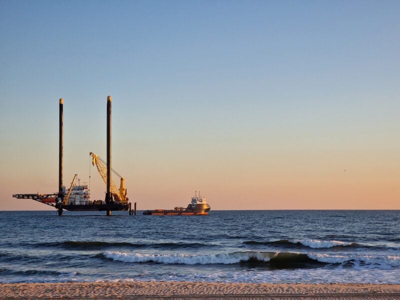

Picture a vessel that can sail to a jobsite, “plant” three or four giant steel legs on the seabed, and then lift its entire hull clear of the waves—creating a steady offshore work platform. That, in a nutshell, is a liftboat. Born in the Gulf of Mexico in the 1950s to serve the offshore oil industry, these agile craft now support everything from well-plugging campaigns off Louisiana to turbine maintenance at the first U.S. offshore wind farms.
How a Liftboat Works
A liftboat, or self-elevating service vessel, looks like a wide-bodied supply vessel with long lattice legs protruding skyward. It sails under its own power or by tow to locations generally less than 300 ft deep. Once on site, hydraulic jacking systems lower the legs until they “pin” on the seabed. The hull then climbs those legs, rising anywhere from 15–70 ft above the water so waves can pass harmlessly below. With the deck as stable as dry land, cranes, crew quarters, workshops, and helidecks can support around-the-clock operations.
