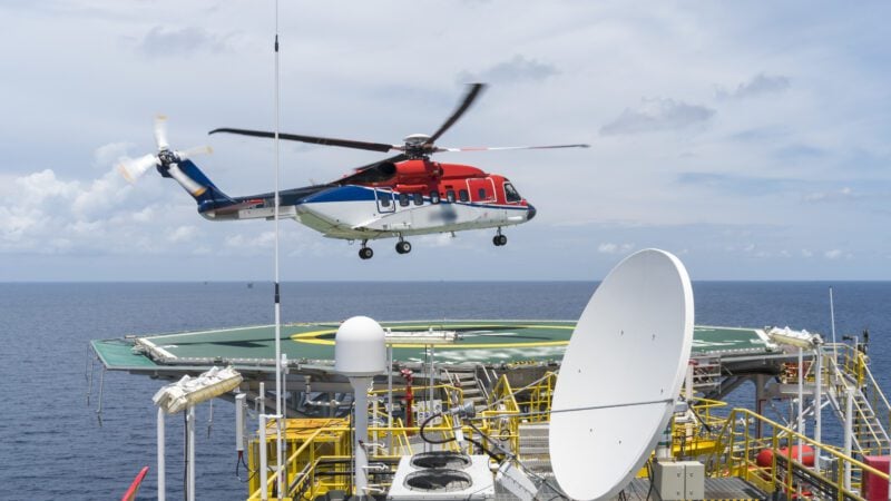

There is no easy way to get to an offshore platform. Located miles from shore, these worksites are often accessed by helicopter—setting the stage for one of the most challenging commutes in the world.
Helicopters have been used in the offshore industry since the late 1940s. As drilling pushed further and further from shore, companies needed a faster and more flexible way to move personnel, equipment, and emergency support between rigs and land. Boats couldn’t compete with the speed or versatility of helicopters, especially in emergencies when every second counts. Helicopters quickly bridged the gap between civilization and isolated platforms and rigs.
Today, helicopters are used for routine crew changes, medical evacuations, supply runs, inspections, and urgent maintenance support. On any given day in regions like the Gulf of Mexico, North Sea, or West Africa, helicopters ferry countless workers and supplies to and from offshore platforms.
Modern offshore helicopters are engineered to handle harsh marine environments and heavy loads. These aircraft are built for precision, and they need to be. Landing on helidecks that sway and shift with the sea, often in difficult weather, leaves little room for error.
