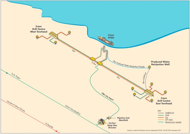

Schematic of the proposed Fram Project, image: Shell (click for larger)

The hull of the FPSO will be based on a converted Aframax tanker and will incorporate an internal turret permanent mooring system. The crude will be offloaded to shuttle tankers and the gas exported via the existing Fulmar pipeline.
Shell’s decision to use this type of FPSO conversion was favoured over a new-build FPSO because of a shorter execution time while accommodating the topsides equipment required for the Fram FPSO. In line with other FPSOs in the central North Sea, this size of vessel is also appropriate for the metocean and environmental conditions.
Conversion of the tanker will take place in an existing shipyard located in the Far East or Middle East. The tanker to be converted will be single decked with a double hull and the upgrades will include:
â– installation of the new turret and swivel, forward of mid-ships allowing the FPSo to weathervane, thus maintaining station keeping without the use of power;
â– installation of either 3 x 3 or 3 x 4 anchor line mooring system;
â– installation of new power and utilities modules;
â– installation of topsides process modules;
â– installation of new flare;
â– installation of new offloading arrangements;
â– new or upgraded accommodation; and
â– installation of helideck.

The Fram field is an oil and gas condensate field located in the UK central North Sea approximately 221 km southeast of Aberdeen. the field will be developed via two subsea production well templates connected to a FPSO. Oil will be exported via shuttle tanker, and gas via a new 18 km pipeline connected to the existing Fulmar Gas Pipeline.
