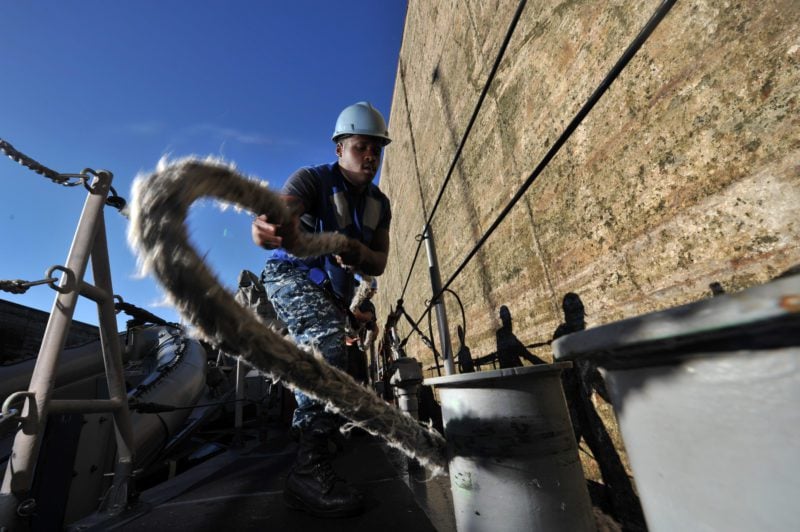

Most of the Great Lakes are naturally navigable, except for the lock systems that separate the Lakes from the Seaway, and locks at separate several of the Lakes themselves. As Salties head west from Montreal, they encounter a series of locks prior to entering the first if the Lakes – Lake Ontario. From Lake Ontario the vessels transit the Welland Canal, which allows vessels to bypass Niagara Falls between Lake Ontario and Lake Erie. This lock system includes eight successive locks that raise or lower vessels 325.5 feet.
The U.S. Coast Guard Cutter Mackinaw locks through the Welland Canal in Ontario, Canada, July 14, 2018. The Mackinaw was locking down into Lake Ontario. (U.S. Coast Guard Photo by Petty Officer 2nd Class Joe Coach)
