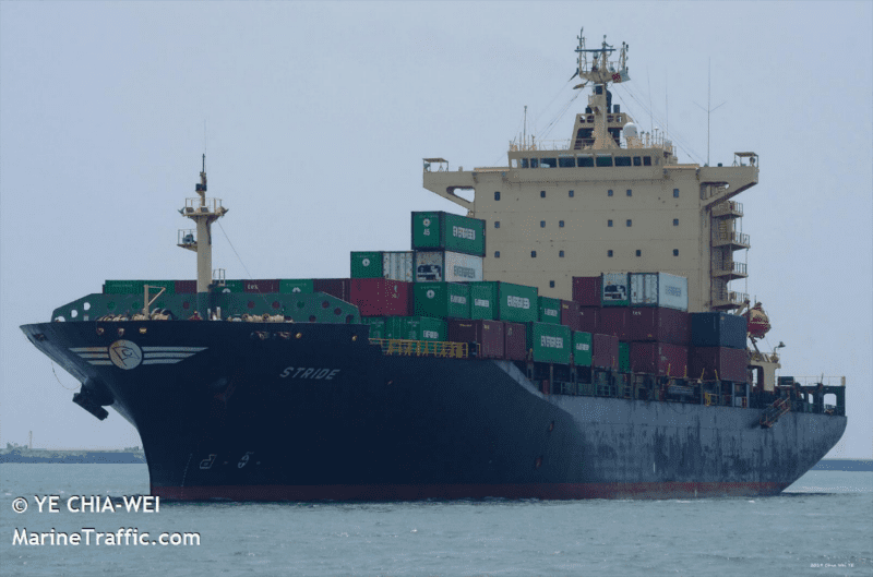

The Stride underway before the fire

A fatal engine room fire aboard the cargo vessel Stride, which claimed two lives and resulted in $12 million in total losses, was caused by the installation of an incorrect valve during routine maintenance, according to a National Transportation Safety Board (NTSB) report released today.
The incident occurred on January 8, 2024, during bunkering operations at the Barbours Cut Marine Terminal in LaPorte, Texas. One additional crew member was seriously injured in the fire, which eventually self-extinguished after the crew shut down engine room ventilation.
NTSB investigators determined that the root cause of the accident stemmed from the installation of an angle stop check valve instead of the specified angle stop valve in the vessel’s port double bottom diesel oil (DBDO) tank. This critical error occurred approximately six weeks before the incident.
The incorrect valve installation created a cascade of events during bunkering operations. When one tank reached capacity, diesel oil was redirected through a common vent line instead of flowing into the intended DBDO tank. The fuel then escaped through a previously sealed cut-out section in the vent pipe, where temporary sealing and tape failed to contain the flow. The escaped diesel oil cascaded onto operating machinery in the engine room, igniting the fatal fire.
