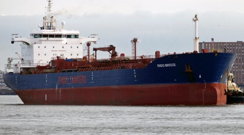

Tank vessel Endo Breeze underway after the fire. (Source: Martine Klingsick, Shipspotting.com)

An engine room fire aboard a Maltese-flagged tanker last year that resulted in $1.2 million in damages was caused by a maintenance error, according to the National Transportation Safety Board (NTSB).
The incident occurred on April 29, 2022, as the Endo Breeze was transiting through the Raritan Bay West Reach channel near Staten Island, New York.
The fire was ignited when oil spray from a fuel injector pump on the starboard main engine came into contact with nearby hot surfaces. The crew of the Endo Breeze acted swiftly and contained the fire by removing fuel and oxygen sources, as well as activating the vessel’s fixed fire extinguishing system.
Upon investigation, the NTSB determined that the cause of the oil spray was a slight offset on the banjo tube assembly of the engine’s no. 1 cylinder fuel injector pump. It was found that the engineer had not correctly followed the manufacturer’s procedure for fuel injector pump reassembly during maintenance conducted a day prior to the fire.
