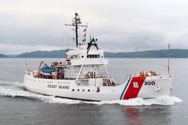

File photo shows the USCGC Citrus in 1984 after her conversion to a medium-endurance cutter following the 1979 allision with a submerged object in the Ouzinkie Narrows.
