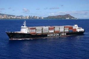

Horizon Lines’ Horizon Spirit.
Horizon Lines is in the preliminary stages of converting two of its Jones Act-qualified, steam-powered containerships to the use of dual fuel… at a foreign shipyard!
Tim Colton over at Colton Company on Wednesday obtained a preliminary determination from the U.S. Coast Guard that grants Horizon Lines permission to hire a foreign shipyard for the convertion two of the company’s 33-year-old LASH ships, Horizon Reliance and Horizon Spirit, from steam propulsion to dual-fuel LNG/diesel propulsion.
