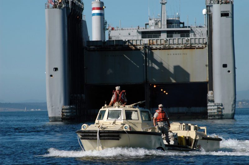

SEABEE Heavy Lift Ship Cape Mendocino underway.

The Sea Barge (SEABEE) can carry the aircraft of Army units without extensive sectionalization. The 200- by 100-foot (61- by 30.5-m) deck area between the deckhouse and smokestacks provides a suitable landing area for fly-on/fly-off operations. The SEABEE barges are stored horizontally on 3 decks, 12 each on the main and lower decks and 14 on the upper deck. One hundred and sixty containers can be carried on 10 of the 14 barges on the upper deck. Barges are loaded aboard the SEABEE ship by a 2,000-ton-capacity submersible stern elevator. Under ideal conditions the SEABEE ship can load or discharge its load in 13 hours.
