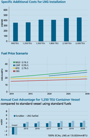

The same main assumptions were used for this study as for the GL-MAN joint study, on LNG for large container vessels. However, in the present study, LNG tank volumes were chosen to give the selected vessels full roundtrip endurance on the relevant routes. This effectively reduces uncertainties associated with the LNG supply infrastructure. The calculated costs for on-board LNG systems cover the tanks, the bunker station, gas preparation equipment, gas lines and the engine. Type-C tanks were assumed for all vessels in this study.
The fuel price scenario from the GL-MAN joint study was used in this study, as well. Small scale LNG distribution costs of $4 USD/mmBTU were added to the current wholesale LNG price in northern Europe.
Results
The annual cost advantages compared to the reference vessel can be computed using the assumptions described above for each technology and vessel size. For a 1,250 TEU vessel using LNG or scrubber technology the study predicts significant annual cost advantages and rapid payback from 2015 onwards for ships operating exclusively inside ECAs.
The benefits of technologies such as LNG or scrubbers depend strongly on their usage. The higher the ECA exposure, the shorter the payback time for all vessel sizes. Payback time is shorter for the smaller container vessels (900 TEU and 1,250 TEU) since the capital investment needed for their LNG systems is smaller than for larger vessels.
The LNG tank accounts for the largest portion of the additional investment. In this study, all vessel sizes are assumed to be equipped with type-C tanks. Payback time roughly doubles with a doubling in specific LNG tank system costs. Changes in LNG distribution costs will significantly affect the payback scenarios. Within ECAs, the fuel of choice is MGO, and the price difference between MGO and LNG is the key factor determining the payback time for LNG technology. At current prices, the difference is significant enough to yield rapid payback for all vessel sizes. Payback is similar for vessels with identical ECA exposure levels.
Conclusions
Using LNG as a ship fuel can be assumed to result in lower emissions and, given the right circumstances, lower fuel costs. For container feeder vessels mostly operating inside ECAs, the relative attractiveness of LNG as a ship fuel compared to scrubber systems mainly depends on LNG price levels. At a difference of 6 to 8 USD/mmBTU or more between MGO and LNG, an LNG system will be more profitable than a scrubber system.
