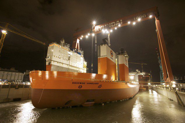

Illustration showing the Costa Concordia onboard Dockwise Vanguard. Image courtesy Boskalis

Heavy lift company Dockwise, a wholly-owned subsidiary of Netherlands-based Royal Boskalis Westminster, said Thursday it has been awarded a contract from Costa Crociere to load and transport the Costa Concordia wreckage from Isola del Giglio onboard the companies new Type-O vessel, Dockwise Vanguard.
Dockwise Vanguard. Rendering courtesy Dockwise
With 117,000 metric ton lifting capacity, the Dockwise Vanguard is the world’s largest semi-submersible ship uniquely positioned to lift and transport massive cargoes in a dry and safe manner. The ship was initially designed to transport offshore oil and gas structures, but can also carry other vessels or even act as an offshore dry dock facility.
The Dockwise Vanguard features an open and flat stern and bow-less deck measuring 275 meters by 70 meters allowing the vessel to transport cargo longer and wider than the deck itself. When the ballast tanks are flooded, the ship deck submerges below the surface, allowing her to handle deep draught cargoes such as the Costa Concordia. Once the Dockwise Vanguard is submersed, the refloated Costa Concordia will be brought into position above the deck and as the ballast tanks are emptied, the entire ship including the Costa Concordia is brought above the water line, completely eliminating the need to tow the wreck into open water.
Once loaded, the Dockwise Vanguard will transport the wreckage to an as of yet undecided location where it will be offloaded -either by float off or “skid off,” meaning transferred directly to a pier- and eventually scrapped. Original plans called for the Costa Concordia to be refloated and towed to a port in Italy for demolition, but by using the Dockwise Vanguard, once the ship is loaded, the options for scrapping are wide open.
