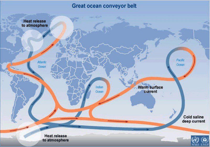

The theory that global warming is driven by ocean cycles seems to have some validity. Increasing atmospheric CO2 does have a role here, however, the longer-term ocean cycles may have an equal or possibly stronger effect. Besides the multi-decadal ocean cycles like the PDO, it is theorized that the Thermohaline Circulation (the global ocean current conveyor belt) runs in cycles that can extend out 100 years or more. As this circulation increases you get more mixing and thus colder sea surface temperatures and when if slows down you get less mixing and therefore warmer sea surface temperatures.
