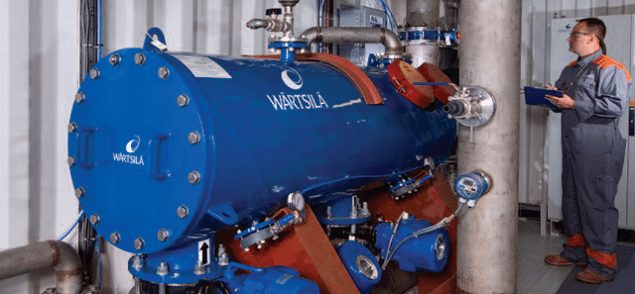

Upcoming environmental regulations will affect existing vessels, and as a consequence there is a growing demand for exhaust gas cleaning and ballast water treatment systems. Retrofitting both scrubbers and ballast water management systems is – or will soon be – required for many ships to comply with regulations. There are retrofit solutions available across all ship types, from cruise vessels to merchant and offshore ships. Space requirement is usually the most critical factor when planning and executing a retrofit project but Wärtsilä has found solutions to the challenge.
The execution of retrofit projects for both scrubbers and ballast water management systems requires similar types of planning and engineering. There are typically three things that are analysed when planning a retrofit of exhaust gas or a water cleaning system. First, the space requirements of the system are analysed, taking into consideration the available space in the vessel. Next, engineers study the impact of the additional systems in terms of their weight, ship stability in case of scrubber systems, structural modifications, and relocation of any existing equipment inside the ship. Finally, engineers assess how to further optimise the installation method, with the aim of minimising costs and downtime during installation.
“Retrofitting exhaust gas or ballast water cleaning systems is feasible for all ship types – but how it is done can vary depending on the ship type. Finding space for the system is the most common challenge. When it comes to scrubber installations, we, for example, sometimes need to make changes in the funnel shape or rethink the use of spaces in the vessel to create more room for cleaning systems. However, we have not come across any project in which retrofitting would not be possible. It is just a matter of identifying the best solution or compromise with the ship owner,” says Leonardo Sonzio, Director Retrofit, Wärtsilä Environmental Solutions.
