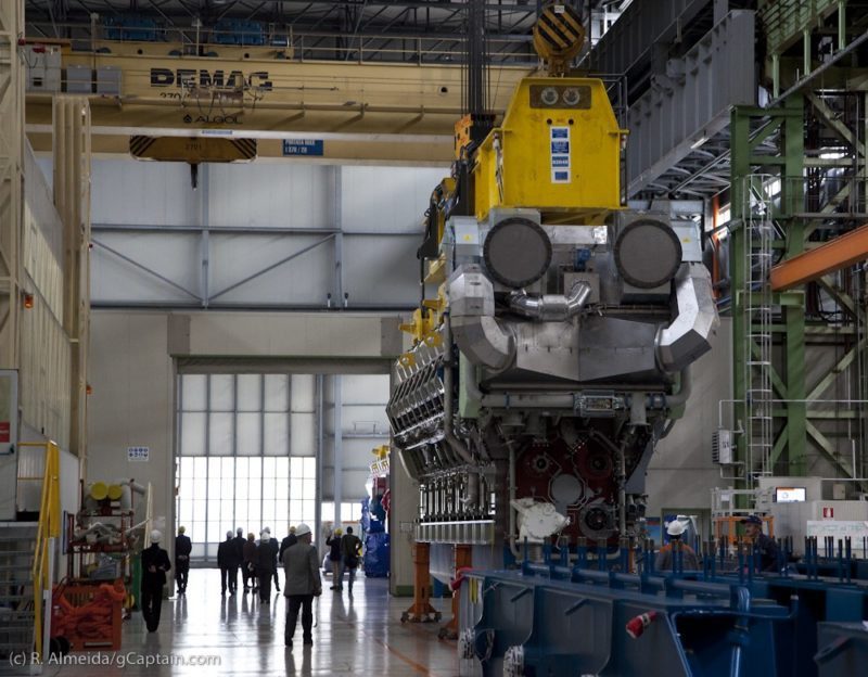

Wartsila’s manufacturing plant in Trieste, Italy. Phot: Rob Almeida/gCaptain
