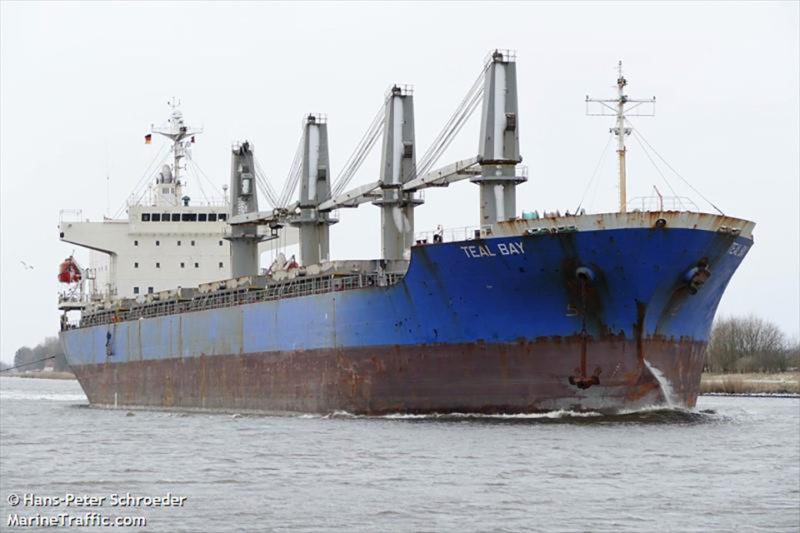

The chief officer of the Isle of Man-registered MV Teal Bay was fatally injured August 30, 2021 when he was struck in the head by a mooring line when it sprang out of an open roller fairlead at Russia’s Kavkaz South anchorage.
The Teal Bay was moored alongside an anchored bulk carrier and was being moved forward by tensioning the aft spring to allow loading to be completed. According to the MAIB, during the loading operation, Teal Bay’s mooring lines had developed an upward lead due to the change in freeboard between the two vessels and, as the line was tensioned to move Teal Bay, its upward lead angle became too great for the open fairlead to contain it.
The MAIB’s investigation found that the use of an open fairlead was inappropriate during the transfer of cargo where a freeboard differential created the hazard of an upward lead on the mooring lines. The chief officer was struck because he was standing in a hazardous area close to a tensioned mooring line and the operation to move Teal Bay forward was attempted with insufficient crew and had not been risk assessed, the agency said.
