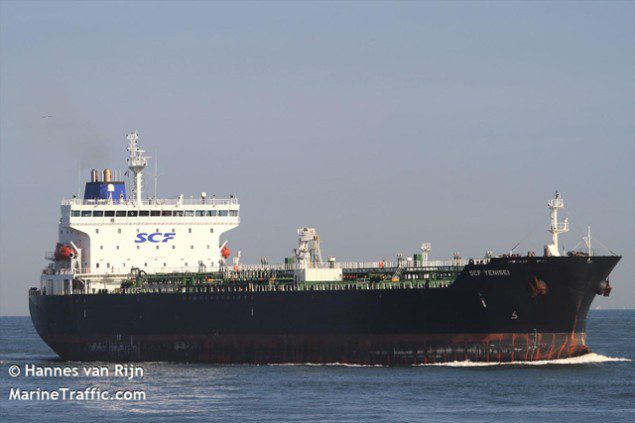

Australia’s Administrative Appeals Tribunal last week affirmed the Australian Maritime Safety Authority’s October 2013 detention of the 2007-built Liberian-flagged product tanker SCF Yenisei.
The vessel is operated by SCF Unicom, a Sovcomflot subsidiary and last year sailed to Mackay, Australia through the Great Barrier Reef without using the proper navigational charts, according to the AMSA.
An AMSA surveyor found that the ship was using scanned and printed charts in order to transit Palm Passage, a route that was different from the original planned passage through Hydrographers Passage.
