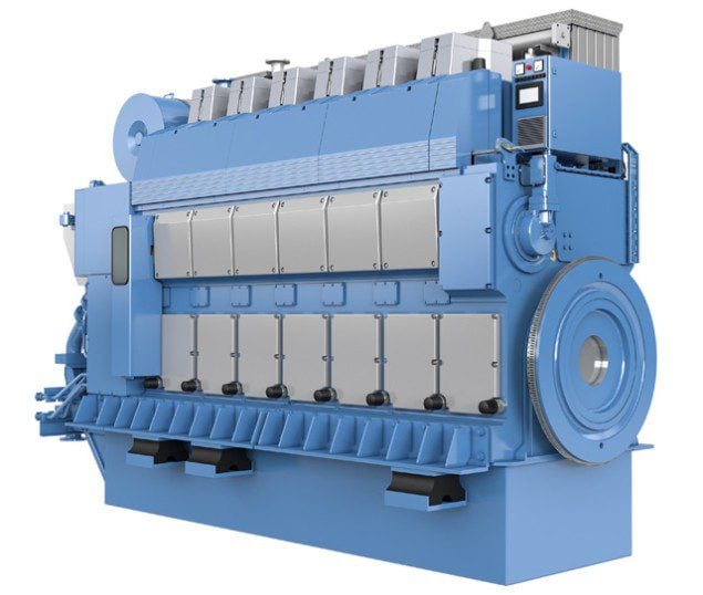

New Engine for Rolls-Royce:
Rolls-Royce Bergen B33.45 propulsion engine
For the first time in 10 years, Rolls-Royce is rolling out an entirely new line of 4-stroke medium speed engines. The B33.45 is an IMO tier II and tier III compliant engine (while using an SCR system) engine that features a modular design and higher power density that its predecessors due to 20% greater power per cylinder as compared to the B32:40. At the same time, Rolls-Royce notes that this engine will also have reduced fuel consumption as well from 184 g/kWh to 175.
Bergen B33.45 exploded view
The first engine is planned to be delivered in Q2 2015 to Norway’s Prestfjord Seafood, an owner of commercial fishing vessels.
Thor Humerfelt – Programme Director and Bergen Engines commented in a presentation yesterday that the overhaul maintenance schedule of this engine is 20,000 hours or every 5 years, which overlaps with required class surveys.
Rolls-Royce notes however they have a double-digit list of companies who are in serious discussions for this new engine. In 2017, the first LNG version of this engine, a V20, will be rolled out of the factory for use in a power station.
