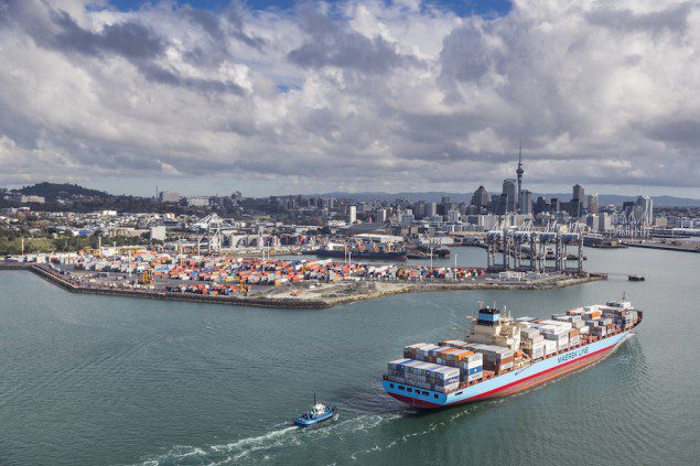

Photo: Ports of Aukland Limited
New Zealand’s Ports of Auckland Ltd (POAL) has been fined NZD$55,000 (US$41,000) and ordered to pay NZD$25,000 in reparation to a stevedore who was seriously injured in a fall while unloading a containership at the port in January 2014.
