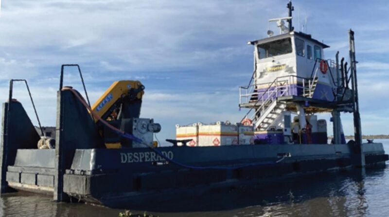

A ruptured hydraulic hose spraying fuel on a hot engine caused a fire aboard a towing vessel in Louisiana’s Lake Salvador, according to the National Transportation Safety Board (NTSB).
The fire ignited in the engine room while the partially-loaded Desperado was transiting near Bayou Perot on February 17, 2023.
