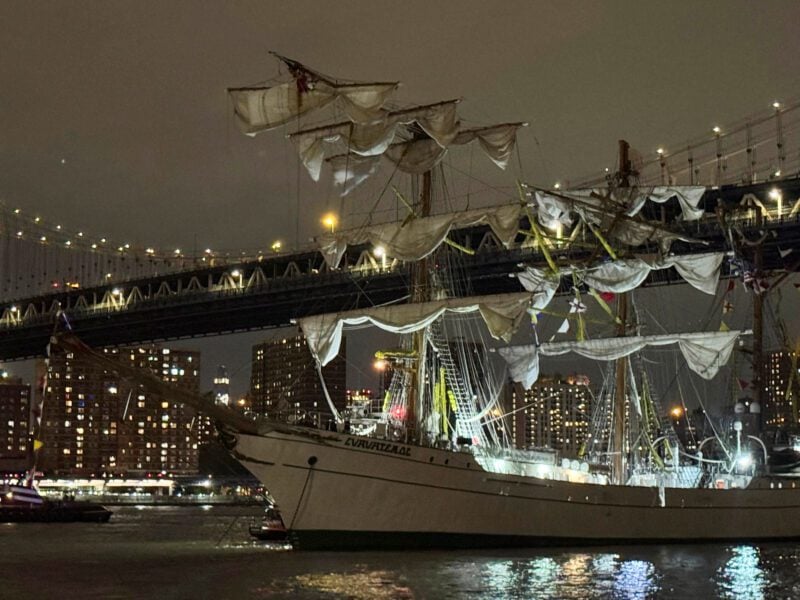

A Mexican Navy training ship is seen in front of the Manhattan Bridge, after it was damaged having run into into the Brooklyn Bridge in New York City, U.S., May 17, 2025. REUTERS/Santiago Lyon

According to the NTSB report, the three-masted steel vessel, with 277 crewmembers and cadets aboard, was departing from Pier 17 in Manhattan when it struck the underside of the Brooklyn Bridge at approximately 2024 eastern daylight time. The impact damaged all three of the ship’s masts and caused injuries ranging from minor to serious. The estimated damage is expected to exceed $500,000.
The incident began when the vessel, built in 1982 and powered by a 1,300-hp diesel engine, was maneuvering away from the pier with assistance from the tugboat Charles D. McAllister. The vessel’s reported air draft was 158 feet, while the Brooklyn Bridge’s vertical clearance at mean high water is documented at 127 feet.

The NTSB report details that “Starting at 2024:42, the upper sections of all three masts of the Cuauhtémoc contacted the underside of the Brooklyn Bridge, one by one.” The vessel was traveling about 5.9 knots astern when the collision occurred.
Following the impact, the vessel continued astern under the bridge, with its stern contacting a seawall on the Brooklyn side of the East River. Emergency responders arrived around 2030, transporting injured crewmembers to local hospitals. The vessel was later towed to Pier 36 in Manhattan.
Inspectors from the New York City Department of Transportation assessed the damage to the Brooklyn Bridge, finding “no significant structural damage.” Their assessment identified impact points to the traveler rail, minor scrapes to paint on a main bridge span, and damage to a maintenance platform’s docking area.
