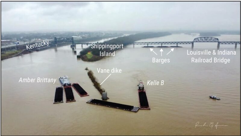

An aerial view of The Amber Brittany with three barges after the accident
The Amber Brittany with three barges, and tug Kelle B assisting, after the tow broke apart. Eight barges that broke free from the tow are lodged alongside the L&I Railroad Bridge pilings. NTSB illustration. Background source: Rich Ammon

The National Transportation Safety Board (NTSB) has determined that an inexperienced pilot’s failure to compensate for outdraft current, combined with cell phone use, led to a costly towing vessel accident on the Ohio River in March 2024.
The incident occurred when the towing vessel Amber Brittany, pushing 15 barges, struck a vane dike while navigating out of the McAlpine Locks in Louisville, Kentucky. The collision caused the tow to break apart, sending 10 barges downstream and resulting in approximately $1.3 million in damage to barges, cargo, and dam gates.
According to investigators, the accident sequence began as the Amber Brittany made a port turn while passing under the L&I Railroad Bridge. The vessel encountered a strong outdraft current – a flow moving across the lock entrance toward the dam – created by nearly fully open dam gates and rising river levels. Despite the pilot’s attempts, they failed to effectively counteract the current’s force.
The investigation revealed two critical factors contributing to the accident. First, the pilot lacked experience navigating the McAlpine Locks and Dam area. While company personnel believed the pilot had previous Ohio River experience, they later admitted to investigators having no prior operations in the area.
Second, cell phone records showed the pilot was actively using their personal phone immediately before the incident, with text messages coinciding with the vessel’s departure from its intended course.
