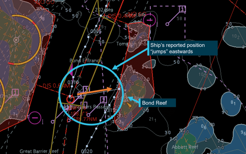

The incident occurred early on the morning of May 4, 2022, when the 225-meter bulk carrier Rosco Poplar was navigating Hydrographers Passage under the guidance of a coastal pilot. Unbeknownst to the pilot and crew, one of the ship’s three GPS units began outputting incorrect positional data, likely due to an antenna malfunction.
This malfunction caused the ship’s incorrect position to be displayed on all navigational equipment, including the electronic chart display and information system, radars, and automatic identification system. As the vessel came within 200 meters of Bond Reef, where a normal clearance would be about 1,500 meters, the pilot suddenly noticed a reef sector light indicating red, followed by an alert from the ship’s electronic navigational equipment.
The pilot immediately ordered a heading change, steering the ship away from the reef. The remaining journey continued without further incidents.
The investigation highlighted that the pilot and bridge team relied solely on GPS positioning to monitor the ship’s progress. The pilot also failed to configure their portable pilot unit to operate independently of the ship’s position sensors. Ineffective bridge resource management and pilotage were also cited as contributing factors.
