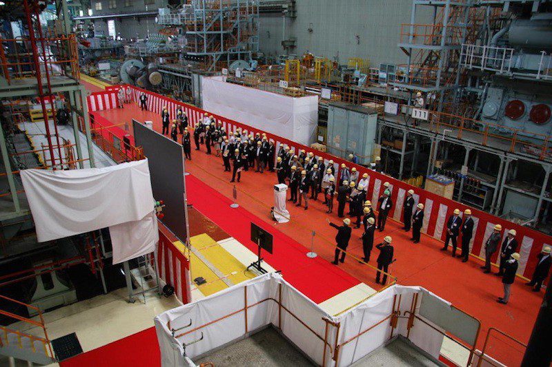

Photo from the ME-LGI demonstration at the Tamano in Japan. Photo: MAN Diesel and Turbo
MAN Diesel & Turbo licensee Mitsui Engineering & Shipbuilding Co., Ltd. (MES) has for the first time successfully demonstrated the liquid-gas-injection concept in Japan using the very first ME-LGI engine to ever be commercially produced.
The successful demonstration took place on 17 June, 2015 at MES’ facility in Tamano, Japan in front of about 60 invited guests from the marine industry.
