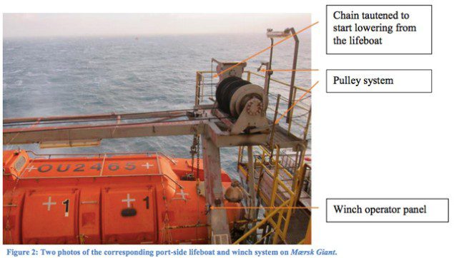

While testing the lifeboat systems on 14 January 2015, one of the lifeboats unintentionally descended to the sea when the manual brake on the lifeboat winch failed to engage. The PSA says that upon entering the water, the lifeboat drifted beneath the unit and the steel wires holding it were quickly torn off due to the weather conditions.
The Maersk Giant has a total of four conventional davit-lowered lifeboats, of which two are of the Waterman-type with a Schat FDA 101/22 davit installed in 1994 – the type that were involved in this incident.
Image via PSA Norway

The following nonconformities were identified by the PSA’s investigation:
These related to maintenance routines for the lifeboat davit system
Training
Procedures relating to lifeboats and evacuation
Periodic programme for competent control and ensuring the expertise of personnel carrying out maintenance work
Qualification and follow-up of contractors.
