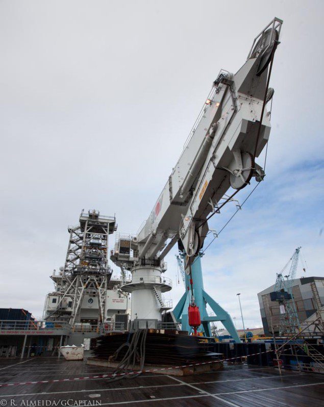

NOV’s 250 ton active heave compensated crane, (c) R. Almeida/gCaptain, click for larger,
None of the cable for the main crane is reeled inside the crane itself, but rather below-decks.
Having 3000 meters of cable that is as wide in diameter as a grapefruit spooled above the main deck would create a significant stability problem for the vessel and is the primary reason for it being stored below according to Håvard Stave, Sales and Projects Director at Ulstein.
The hydraulic hoses pictured below power the active heave compensation for the 250 ton crane which is pressurized by a half dozen or more large nitrogen canisters mounted inside the crane machinery space.
