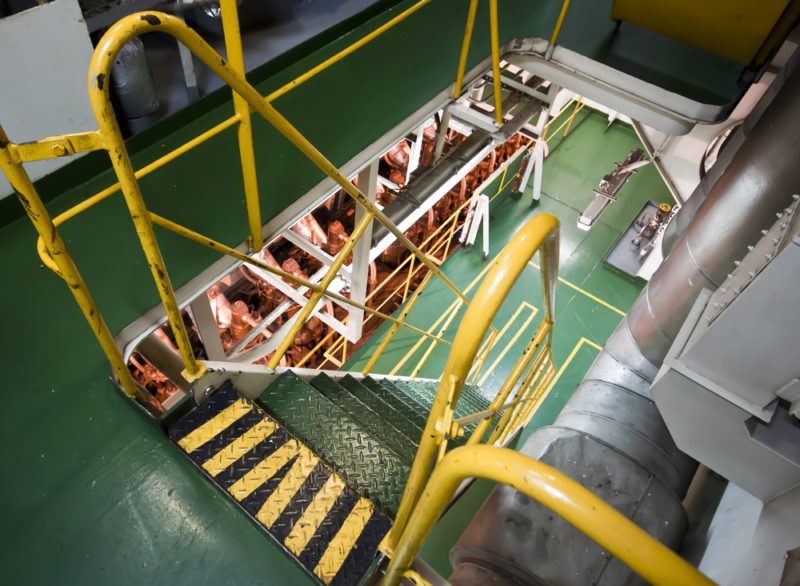

ship engine room

Photo: By donvictorio / Shutterstock
