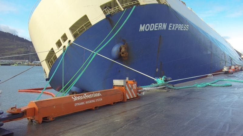

The ship was towed into Bilbao two days later. There, another challenge awaited: how to keep the vessel, with a 51-degree list, from turning over at her berth. The problem was that the severity of the list meant that all the lines securing her had to be under the same amount of constant tension. As the ship was unloaded, this tension would have to be constantly adjusted. SMIT therefore asked ShoreTension to mobilize its ShoreTension system to securely moor the Modern Express.
A job for the ShoreTension Dynamic Mooring System
Designed around high strength lightweight ropes made with Dyneema®, the ShoreTension system adds high pre-tension to reduce the loads on the mooring lines. This, along with a fendering system, reduces ship movement and downtimes significantly.
In the case of the Modern Express, the constant tension proved to be advantageous for the ship’s safe and stable mooring and subsequent righting. The ShoreTension units didn’t get in the way of the salvage operations and significantly reduced the risks of changing-out or replacing mooring lines during them.
Altogether, six ShoreTension units equipped with mooring lines made with Dyneema® held the Modern Express in position until the drama and danger were truly over.
modern-express-moored-with-shoretension-system
