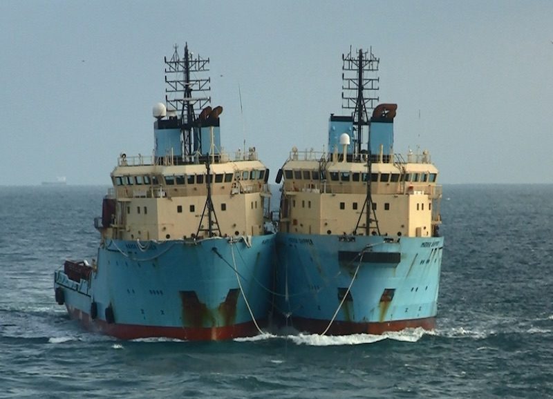

Towage at noon on 20 December 2016 in the English Channel. Left: MÆRSK SEARCHER. Source: Private photo via DMAIB

The supply ships were unmanned at the time and configured in a side-by-side towing setup during the voyage. But during passage through the English Channel, the fenders between the ships on tow failed, and the ships started to collide. The constant battering caused extensive damage to the vessels and eventually compromised the watertight integrity of the Maersk Searcher, causing it to take on water and sink. Subsequently, the Maersk Shipper was also pulled under, so the crew on the Maersk Battler cut both ships loose.
The report stated that the side-by-side towing configuration, which was criticised by some in the aftermath of the incident, was one of three towing methods considered for the job. The two others included a double tow using two winches and a serial tow (one after the other).
Towage at noon on 21 December 2016 leaving the English Channel at the Celtic Sea. Source: Private photo via DMAIBMÆRSK SEARCHER capsizing and sinking on 22 December 2016, just past midnight. Source: Private photo via DMAIB
