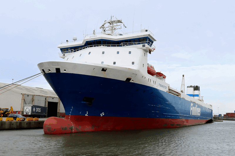

M/V Finnmaster at berth
M/V Finnmaster. Photo courtesy MAIB
