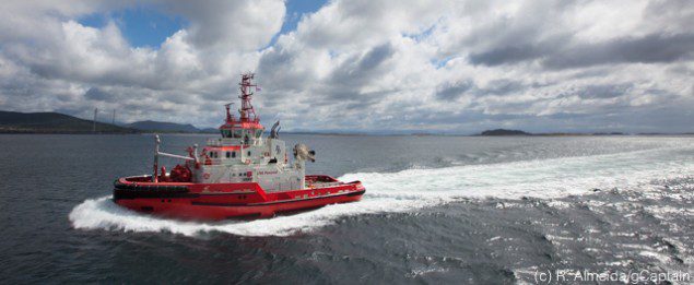

MV Borgoy
The two tugs are powered by lean-burn LNG-fueled C26:33L6P engines from Rolls-Royce, with a combined output of 3410kW at 1,000 rev/min. They are the first tugs in the world to be 100 percent LNG-powered. The engines drive a pair of z-drive azimuthing 3,000 mm thrusters.
They come at a higher building cost than conventional tugs, and subsequently higher contract rates, however they provide an far more environmentally-friendly option – one specifically requested by Statoil and delivered by Buksèr og Berging’s engineering staff, along with Rolls-Royce.
M/T Bokn and M/T Borgoy
