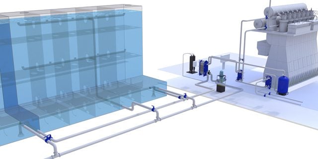

In simple terms, his system cooks and then deoxygenates the ship’s ballast water to kill all the critters that enter the ballast tanks while in port. The vast majority of other ballast water treatment systems, of which there are many, utilize in-line mechanical filtering and UV radiation to eliminate these organisms.
Rendering courtesy BAWAT

Heating up tens, or hundreds of thousands of gallons of seawater to 70 degrees C is not an easy task however, nor is it cheap – or so the skeptics thought.
In reality, it’s quite a simple process and by using waste heat from the ship’s main engine, it can be quite inexpensive as well.
Diederichsen’s system, named BAWAT, involves using globally available equipment such as pumps and standard plate-type heat exchangers and a to cycle ballast water through a heat exchanger and then mixed with nitrogen for deoxygenation. The ballast water is then injected into the bottom of the tank through rotary jet heads and fixed nozzles ensuring a thorough mixing.
The BAWAT system takes approximately 24 to 96 hours of treatment time depending on the size of the ship and the capex needed for such a system varies between $250,000 and $2 million, according to Diederichsen.
