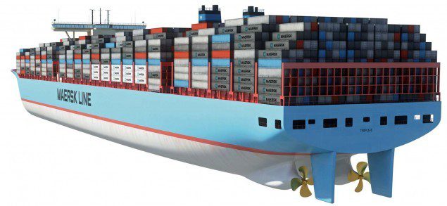

Image: Maersk
(Bloomberg) — A.P. Maersk-Moeller A/S’s planned fleet of the world’s largest container vessels will be as groundbreaking for their shape as their size.
The 20 ships will be the first cargo-box carriers with rounded hulls rather than streamlined V-shaped ones, according to Daewoo Shipbuilding & Marine Engineering Co., which is developing the 18,000-container vessels. The change reflects a shift by operators away from designing ships to go as fast as possible to instead emphasizing fuel economy.
“These vessels will be the Prius of the seas,” said Lee Jae Won, an analyst at Tongyang Securities Inc. in Seoul, referring to Toyota Motor Corp.’s distinctively-shaped hybrid car. “They’re fuel efficient and environmentally friendly.”
The fatter hulls will let Copenhagen-based Maersk install a fuel-efficient two-engine setup that’s too wide for current ships. It will also recover cargo capacity that is lost with tapered hulls, letting the ships carry 16 percent more boxes than vessels only a few meters smaller. Combined with other technologies, the ships will use about 35 percent less fuel per box than vessels now used on Asia-Europe routes and produce around 50 percent less carbon emissions, according to Maersk.
“The focus now is on how to consume less fuel,” said Odin Kwon, vice president of ship design at Seoul, South Korea-based Daewoo. “Ships currently in operation have been built only with speed in mind.”
Daewoo has begun the initial work for the first of the ships, which will cost about $183 million each. Deliveries are due to start next year and will run until the first half of 2015. Rounded hulls are common on commodity-carrying ships.

Still, these gains are limited by current ships’ focus on speed as they are fitted with engines that operate best when going fast. By contrast, the Maersk vessels are designed to operate efficiently at both high and low speeds.
Key to the change is the ships’ two propellers and their ultra-long stroke engines, a type usually only found in slow- moving commodity ships and tankers. The setup will use 4 percent less fuel than a single engine and propeller, Maersk said in an e-mailed response to Bloomberg News questions.
“Building vessels that are fuel efficient at different speeds will be the trend,” said Daewoo’s Kwon. “It will eventually dominate the market.”
The Maersk vessels, which will also feature a waste-heat recovery system, will still be able to go as fast as 23 knots. That compares with a top speed of 25 knots for the Emma Maersk, the largest container ship afloat.
The new vessels will be 59 meters wide and 400 meters long. That’s about 3 meters wider and 4 meters longer than the Emma, which holds 2,500 fewer boxes. The limited size increase means major European ports will be able to handle the ships without having to buy new cranes and other equipment. U.S. ports aren’t big enough for such vessels.
