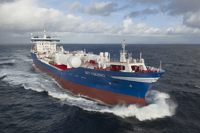

Pictured: Bit Viking courtesy GL

Delivered in 2007, the China-built “Bit Viking” is equipped with double engine rooms, propellers, steering gears, rudders and control systems. Having previously been powered by two 6-cylinder in-line Wärtsilä 46 engines running on heavy fuel oil, the conversion has changed these to 6-cylinder in-line Wärtsilä 50DF dual-fuel engines operating on LNG, supplied by two 500 cubic meter LNG storage tanks on the fore deck.
