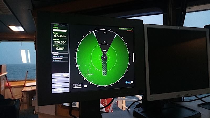

The SceneScan system is a high accuracy rotating laser sensor that provides positional information to allow automated approach and/or station keeping relative to a structure or vessel. It is designed to be straightforward to operate, and it provides tracking information relative to natural or man-made structures within the sensor field of view. It tracks by matching its current observation of the scene against a map generated from previous observations of the scene.
