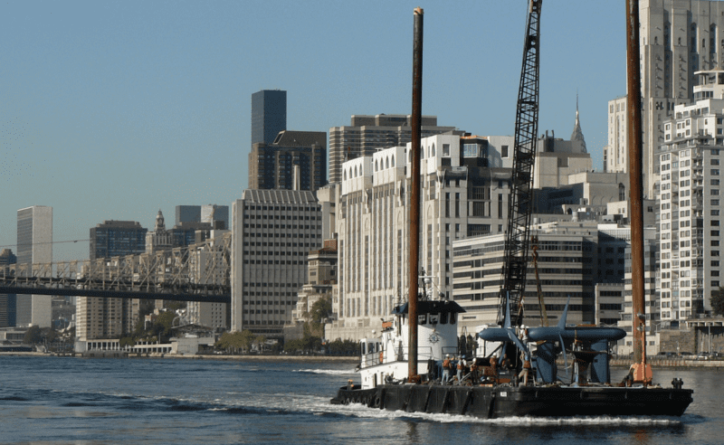

Verdant Power’s tidal turbines for the Roosevelt Island Tidal Energy project make their way down the East River in New York City, New York. Photo courtesy Verdant Energy

Verdant Power, a New York-based marine energy technology company, is installing three small underwater turbines in the river Thursday that will feed power to Consolidated Edison Inc.’s grid.
“We want to prove we have the basis of a commercial, standard system that can be scaled, ” Verdant Chief Executive Officer John Banigan said in an interview.
Marine energy has been around for years, but its adoption has been stymied by high costs and mechanical issues. Verdant’s system, big enough to power a handful of homes, is expected to showcase the technology as the company works on a large, commercial project in the U.K. that may be installed in 2023.
The turbines have five-meter (16-foot) rotors, half the size of what Verdant is planning for the U.K. project, with 35 kilowatts of capacity each, about four times bigger than a typical U.S. residential rooftop solar system.
