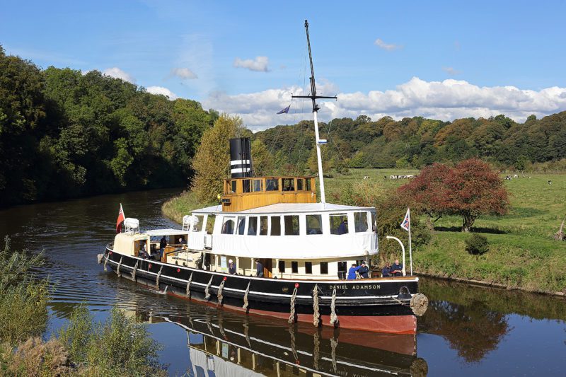

Press Release – One of the world’s oldest tugboats, the 117-year-old, steam-driven Daniel Adamson, is set to return to service offering short cruises along the River Weaver, a tributary of the fabled Mersey River in England, after the completion of a project to install new propeller shaft bearings.
The 1903-built steamship, rescued from scrap merchants 15 years ago, was fully restored in 2016 at Birkenhead’s Cammell Laird yard, the original builder of the vessel. Thordon Bearings’ SXL water lubricated propeller shaft bearings were installed last year after competitor bearings failed.
Chris Simmons, Sales Manager, Duwel Group, Thordon Bearings’ distributor for the UK, said: “We were invited to visit the yard to investigate the potential to retrofit with a Thordon bearing solution following the loss of the starboard propeller.
“There seemed to be a lot of damage compared to the other journal positions and it appeared the bearing had suffered from hydrolysis. I could see that some areas of the inside diameter surface had deteriorated and were missing.”
Thordon SXL water lubricated bearings were supplied in April of 2020, but due to the COVID-19 crisis, the project was delayed until November. The coal-fired tug, currently in winter lay-up, is expected to resume service in the spring.
“Initially, we were only going to replace the bearing on the starboard shaft but as the project progressed, it was agreed that the port propeller shaft bearing should also be changed. So, we ended up supplying 203mm (8in) diameter SXL bearings for each shaft,” said Simmons.
Andrea Ward, Director, Daniel Adamson Preservation Society, said: “As a charity, supported by volunteers, we didn’t have a big budget available for the docking and bearing replacement so soon after the restoration three years ago. But after evaluating the reliability and robustness of the SXL bearings we believed it would be prudent to the life of the vessel to replace the existing shaft components with the more reliable, robust Thordon SXL solution.”
