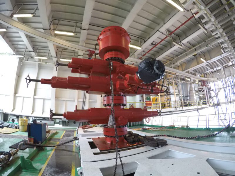

Installed at the wellhead, a blowout preventer performs various functions, from monitoring pressure to sealing off the well in the event of an emergency. There are two primary types of BOPs—ram and annular—each with different functions and designs.
A “BOP stack” typically comprises several individual BOPs, including at least one annular BOP and multiple ram BOPs, each designed to handle specific well control scenarios. Annular BOPs, positioned at the top of the stack, can seal the space around the drill pipe or completely shut off the wellbore when no pipe is present. Ram BOPs can seal around the drill pipe, casing, or tubing, close an open wellbore, or even cut through the drill pipe with steel shearing blades.
The primary roles of a BOP stack include confining well fluid to the wellbore, adding fluid to the wellbore, and allowing controlled withdrawal of fluid. BOPs also regulate and monitor wellbore pressure, centralize and support the drill string, seal the annulus to shut in the well, prevent additional influx from the reservoir, and, in emergencies, sever the casing or drill pipe to seal the well.
The Deepwater Horizon’s 400-ton BOP stack had 2 annular preventers and 5 sets of metal rams: a blind shear ram that was designed to cut through the drill pipe, a casing shear ram designed to cut through the casing, and 3 sets of pipe rams designed to close off the space around the drill pipe. The BOP could be activated manually, by a remote operated vehicle (ROV), or by an automated “deadman” system.
