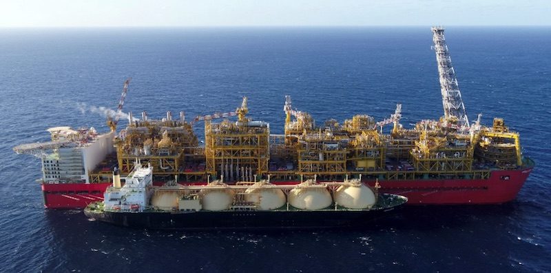

The LNG was imported by the LNG carrier Gallina, arriving from Singapore, marking what was also Prelude’s first ship-to-ship (STS) transfer.
The loaded LNG will give Shell the opportunity to test Prelude’s LNG export systems before the subsea wells are opened at start-up later this year.
During the LNG import, the 290-meter-long Gallina berthed side-by-side with 488 m Prelude and tested its free-moving offloading arms.
Once onboard, the LNG made its way – in reverse order – through process equipment and pipework to huge LNG tanks in the hull of the facility. Since the Prelude is anchored, the tanks have been designed to withstand the ‘sloshing’ of the product that could happen due to the movement of the facility during adverse weather.
Shell says that with the import, four of Prelude’s six 39,000 m3 cryogenic LNG tanks are now full.
With gas onboard, Prelude’s utilities can now switch to run on gas rather than diesel.
