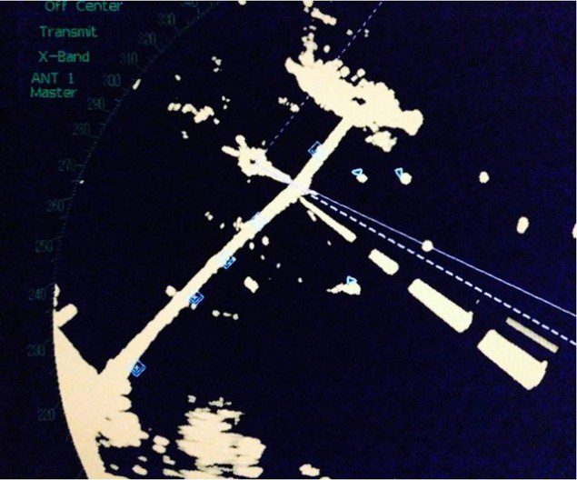

The following image shows what this looks like on a radar console:
Via USCG
As you can see, the center span of the San Francisco-Oakland Bay Bridge is marked by a racon, and the bridge towers themselves are marked by five eATON digital markers.
In addition, eATON currently mark reporting points in the offshore traffic separation scheme (TSS) approaches to San Francisco, the “SF” buoy which serves as the San Francisco Bar Pilot embarkation point, Mile Rocks Light and Harding Rock buoy, which marks a critical turn point for ships in the Central Bay.
A senior Coast Guard official notes that “eATON is not replacing physical aids, but rather this technology is being used to either augment/complement existing physical ATON, or place “virtual” ATON in locations where it may have previously been impractical to do so, such as in water in an offshore TSS which may be too deep for a physical aid, or it’s just not practical or helpful to put a visual day marker on a massive bridge tower, when what you really need is something to help you see it in a low-vis situation).”
